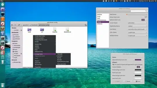

A useful tool to customize gtk theme is gtk-theme-config.
You can see here the greybird gtk theme wich has a blue scheme by default turned to purple and the gtk theme config at the bottom right corner.
Greybird gtk them wich has a blue scheme by default.

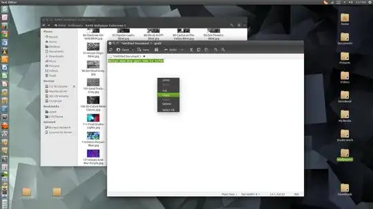

If all you need is more green, just install one of the themes available at ubuntu-art.org:

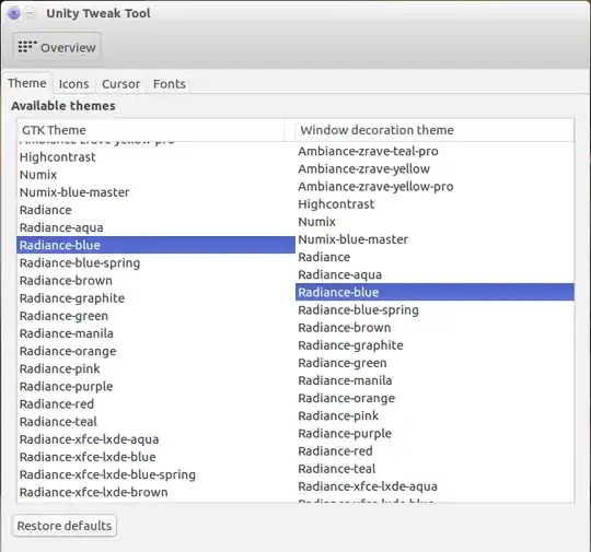

The simplest way is maybe to install the color-varied versions of Radiance and Ambiance: Ambiance & Radiance Colors.
sudo add-apt-repository ppa:ravefinity-project/ppa
sudo apt-get update
sudo apt-get install ambiance-colors radiance-colors
And then change the theme with Unity Tweak Tool.
sudo apt install unity-tweak-tool

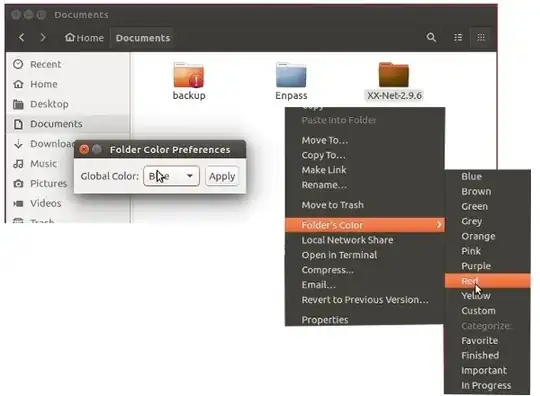

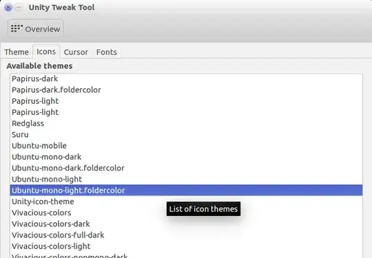

As for the icons, we can change only the color if we want, while keeping the same theme (in fact creating a color-variation version of the default) with:
sudo apt remove folder-color folder-color-caja folder-color-common
sudo add-apt-repository ppa:costales/folder-color
sudo apt update
sudo apt install folder-color folder-color-caja

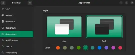

I'm not sure what you were looking for 8 years ago, but in Ubuntu 22.04 LTS you can go to Settings → Appearance, in the Style section go to Color and pick between different shades of green.
color selection in settings->appearance dialog
