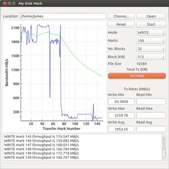

Regardless, I still get these insanely high write through puts that are higher than my read which leads me to believe my write cache is still active. What is the correct way to disable the write cache on a Ubuntu 13.10 system??? i'm attaching a screenshot of a utility I've written that shows my write bw to be insanely high (2.2GB/s) until the write cache is filled up (looks like 1.2gb). Any feedback is greatly appreciated.

Disabling write caching will increase the number of writes to the system. As you can see in the link below
http://ubuntuhandbook.org/index.php/2014/01/disable-disk-caching-prevent-data-loss/
Write caching basically caches the data before the OS can write to the device, any then writes it together. It makes the system fast since you have less number of writes to the device, however it is risky since a power failure will result in the loss of the cached data.
You have turned off the write-cache hence all your writes are directly being written to the drive and thus you have high write througput.
