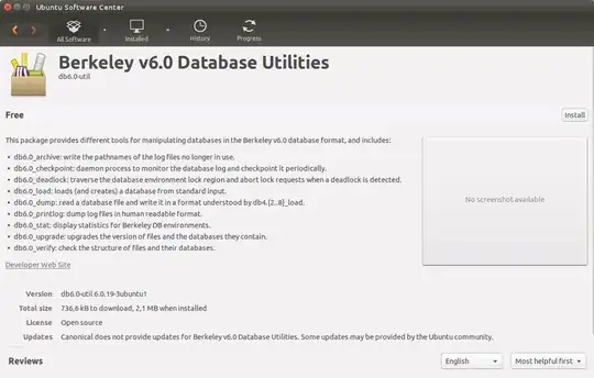

Install db-util. There are several in Ubuntu Software Center (for example db5.3-util). The latest version via command line:
sudo apt-get install db-util
After installing all you need to do is:
db_dump addressbook.db
Description of an old version from USC:
