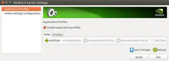

I've followed this tutorial (with the following adjustments below) to install v. 331.67 nVidia driver. But get nvidia-settings (NVIDIA X Server Settings) empty...
Then, before restart the PC, I make a xorg.conf in the nvidia-settings.
The driver make Unity don't start right. So I installed nvidia-331-updates via apt-get and restarted the PC again.
After that, the Unity works fine. But the nvidia-settings gets almost empty...
Empty nvidia-settings
Can someone help !?
Victoralm
  • 1,063
You installed the driver from ubuntu repositories over a driver you manually installed.
Follow that tutorial to uninstall that driver.
Then remove nvidia-updates with sudo apt-get purge nvidia-331-updates nvidia-settings.
Reinstall Nvidia current driver with sudo apt-get install nvidia-331 nvidia-settings
