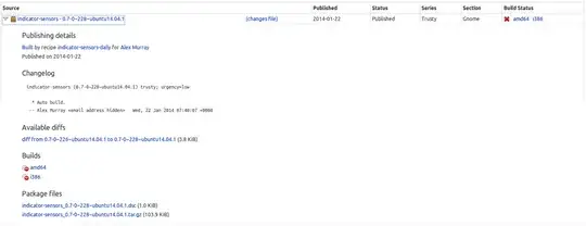

It's still not available for 14.04 Here is the build info for 14.04
