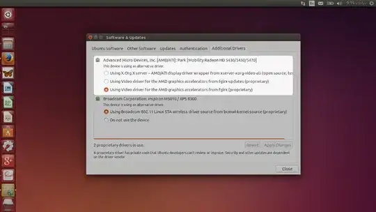

Install your driver though Software center.
Ubuntu software center > Edit menu > Software sources > Additional Drivers
OR
run these commands in your Terminal:
sudo apt-get install build-essential linux-headers-generic
sudo apt-get install fglrx
Then you will be able to use Catalyst Control Center.
