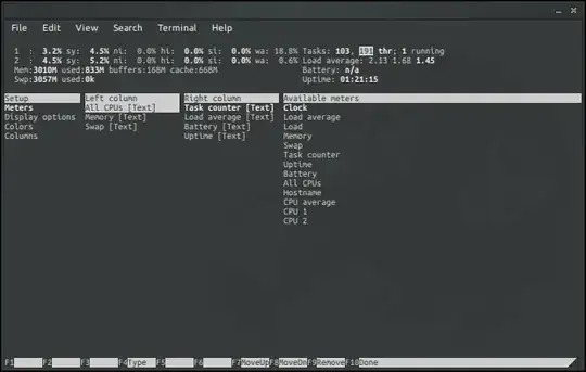

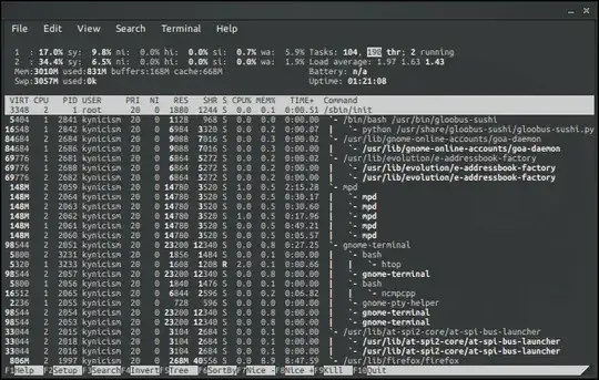

Why not use htop [interactive process viewer]? In order to install it, open a terminal window and type:
sudo apt-get install htop
Also see man htop for more information and how to set it up.
