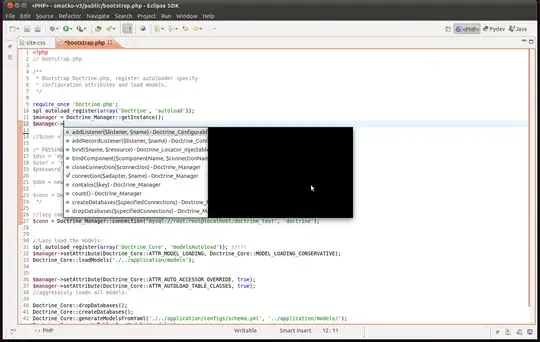

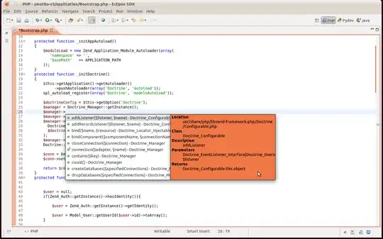

I am having a weird problem with Eclipse documentation tooltips. When I startup Eclipse the tooltip works as expected:
But after I press the down button the tooltip turns black:
and stays like that for the rest of the session.
I am using Eclipse Galileo and Ubuntu 11.04 with the classic desktop.
EDIT: I am only experiencing this problem in PHP Development Tools. The tooltips work in Java and Python projects.
