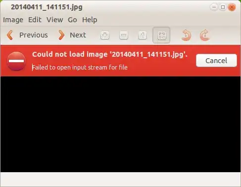

I have just made a fresh install of Ubuntu 14.04.
When I plug in my Android phone by USB, I can access the files on the phone, though not smoothly. Image and sound files won't open unless I copy them to the computer first. Banshee crashes if the Android is connected.
This is the error if I try to open an image file:
"Failed to open input stream for file"
Why am I getting this error and how do I get my Android to connect without problems?

The error which was clearly shown is, Unable to mount MTP device. So your system fails to mount(open) this mtp device. Installing mtp-tools package will solve this error and makes your mtp device to get connected.
sudo apt-get install mtp-tools

Resolved this issue by upgrading to Android 4.4. Now, when I plug in the device, I get an "Android" device in Nautilus, which has two separate drives available, my internal and external SD card. There are no interface actions on the phone needed to connect the device. I actually can't tell if it's connecting using MTP or USB mass storage or what, but so long as it's working, I'm not too concerned about it.
Media files don't have preview icons, but can be opened and viewed without any errors.

Having run into this problem many times, my feeling is, that it appears to happen more often with Samsung phones than with Huawei phones. I have not tested with others.
The problem is by my analysis, that Samsung allows exactly one MTP session after an USB cable has been connected and the user authorized file transfer. However, Ubuntu (and Kubuntu as well) apparently close and re-open the MTP session after already a few seconds of inactivity, or they try to use parallel MTP sessions (like one for directory listings and one for actual file transfer etc.). But the new MTP session is not authorized and boom, there is the error message, and the Samsung phone will even close the already authorized MTP session.
The best workaround is to use mtp-tools to permanently mount the android device. For reference see basically: https://wiki.ubuntuusers.de/MTP/
So I typed in a terminal window:
sudo apt-get install jmtpfs
mkdir ~/samsung
(This needs only to be done once. On older Ubuntu versions, install package mtpfs instead of jmtpfs)
Then each time you want to connect the phone, connect the USB cable, unlock the phone, then on the phone bring up the message list by sliding down from the top, and look for the entry "Android system - USB for nnn". Tap that item, so that an overlay window opens, that lets you set the USB mode. Explicitely select "file transfer". If file transfer is already selected, select something else instead, then bring the window up again, and select "file transfer" a second time. Yes, having to use this window twice smells very much like a Samsung bug.
Sometimes, especially after failed mount attempts, the phone also brings up an "allow phone data access" dialog, that only allows "yes" and "no" as answers. Using that dialog works, too.
After all this preparation, just do:
jmtpfs ~/samsung
And voilá, your long sought after files appear in your ~/samsung directory, and more important, stay there until you disconnect the USB cable or power off either the smartphone or the computer. It doesn't even hurt, if the phone locks its display or turns off the display, as long, as it is not completely off. But don't try to click on the icon for the phone in the Ubuntu/Kubuntu file viewer. That will attempt to open a second MTP session and could actually kill the first MTP session, too. Instead, access the aforementioned ~/samsung directory.
To unmount the phone later, just type:
fusermount -u ~/samsung
This may work with 4.1.2 as well.... cannot confirm
