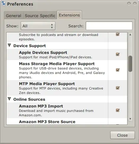

Compare the list of enabled plugins in both instances (Edit > Preferences > Extensions). In particular, check whether "Mass Storage Media Player Support" is enabled.
Banshee Preferences
