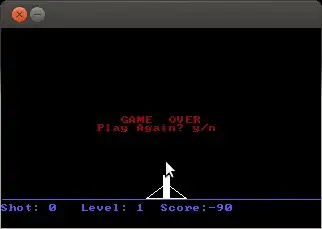

I was testing out FreeBASIC compilier for its ability to make interactive software (in this case, a simple game called Asteroids.)
The .bas code for it is right below:

I used this command to compile the data into a usable application.
$ /usr/local/bin/fbc -lang qb roids.bas
What i got was an error, telling me that i am missing libraries to properly compile this code.
ld: cannot find -lX11
ld: cannot find -lXext
ld: cannot find -lXpm
ld: cannot find -lXrandr
ld: cannot find -lXrender
My question is how and where can i download these libraries in order to properly compile this code and create the small game?
Thank in advance.
Miesrah
  • 37
From the error you got from the FreeBASIC compiler you need to install the following packages:
sudo apt-get install libx11-dev libxext-dev libxpm-dev libxrandr-dev libxrender-dev
When you have to install -dev packages, http://packages.ubuntu.com/ is a good place for finding the library package name.
Finally use /usr/local/bin/fbc -lang qb roids.bas to compile your roids.bas file and start it with:
./roids
