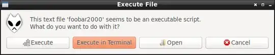

for me simply to go into
/home/shan/.wine/dosdevices/c:/Program Files/foobar2000
of course change shan for your name
copy this location then open Gedit or any text editor and create a file called Foobar2000.desktop and save to Desktop
then enter
[Desktop Entry]
Name=foobar2000
Exec=wine "/home/shan/.wine/drive_c/Program Files/foobar2000/foobar2000.exe"
Type=Application
StartupNotify=true
Path=/home/shan/.wine/dosdevices/c:/Program Files/foobar2000
Icon=B093_foobar2000.0
StartupWMClass=foobar2000.exe
(Of course your icon might be different)
and then click on it in Ubuntu it will say enter image description here
Click on execute it takes a few seconds then Foobar appears
