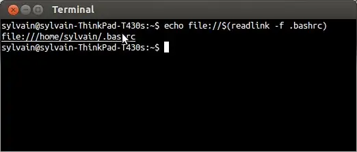

Only links can be opened from a terminal (right-click -> Open Link), basically you'd need to prefix your file path with the full URI:
/home/dell/pcl/2d/include/pcl/2d/impl/keypoint.hpp
becoming (just add the file:// prefix):
file:///home/dell/pcl/2d/include/pcl/2d/impl/keypoint.hpp
Note: This command will give you the absolute path URI to a file:
echo file://$(readlink -f <your file>)
Personally gedit /home/dell/pcl/2d/include/pcl/2d/impl/keypoint.hpp is probably the best option.
