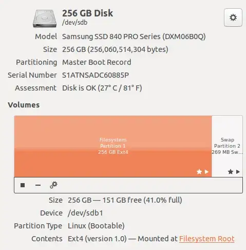

Here is Ubuntu 13.10 on my SSD:
As you can see, is totally safe, secured, faster, stable and with a big jump in performance.
