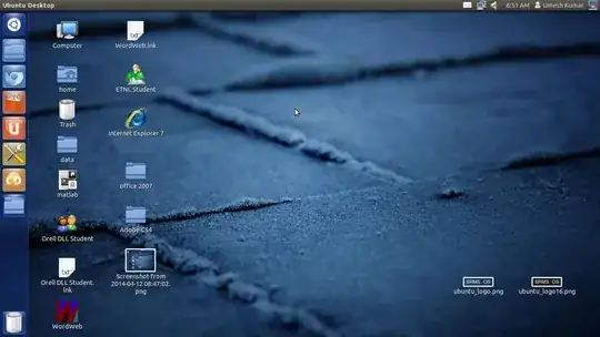

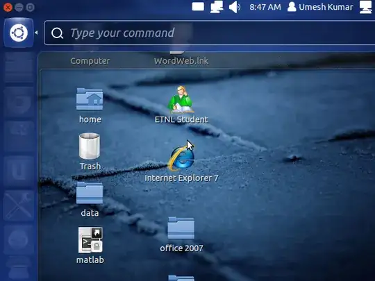

My Desktop before opening DOSBOX My Desktop on exit the DOSBOX

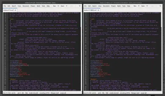

You can edit and then adjust the screen resolution for DosBox window in:
/home/username/.dosbox/dosbox-0.7x.conf
Please see Line 27 windowresolution=value - simple change the value as suggested from 320x240 to whatever you want, then save the .conf-file. (Please make a backup copy of the original .conf, before changing anything, just in case!!)
See list of possible value options available:
  • Use fullscreen=true for full screen
  • Use fullscreen=false for DOSBox in a window
  • Change fullresolution=original to fullresolution=desktop
  • When using a window, change windowresolution=original to windowresolution=1280x1024 (or use 1024x768 for a smaller window)
  • Change output=surface to output=openglnb (uses graphics hardware and maintains crisp image with scaling).
  • You might try output=ddraw, which in some cases has a lower CPU load. Scroll down to the [render] section
  • Change aspect=false to aspect=true (maintains 4:3 aspect ratio, otherwise keep on false if you like the aspect ratio of your screen, mostly 16:9 or 16:10 nowadays)
  • Save the configuration file with Ctrl+s (or File - Save) (Re)start DOSBox.

After using Alt+Enter, the only way to restore your initial resolution is to open the Displays properties (Open first System Settings).
After closing Dosbox, my display resolution was 1152x864, I just had to select 1920x1200 to recover my initial resolution.
Depending on how Dosbox lower your resolution, you could open the Displays settings before starting Dosbox.
