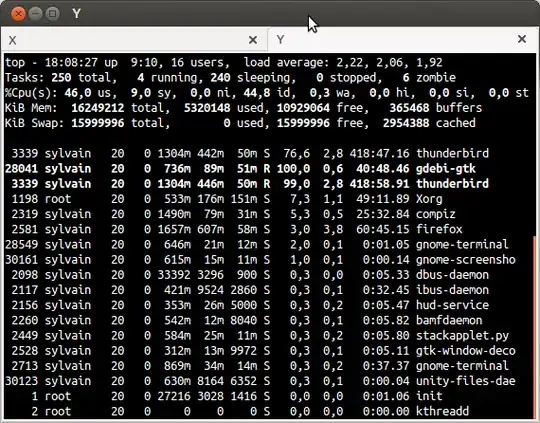

To keep the tab titles you need to comment the following lines in your .bashrc:
# If this is an xterm set the title to user@host:dir
#case "$TERM" in
#xterm*|rxvt*)
#    PS1="\[\e]0;${debian_chroot:+($debian_chroot)}\u@\h: \w\a\]$PS1"
#esac
Then gnome-terminal --tab -t "X" -e "bash" --tab -t "Y" -e "top" will work as expected:

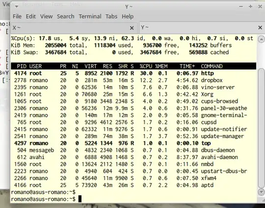

I'll do the following:
Step 1: call the terminal with shells, adding environment variables like that:
gnome-terminal --tab -t X -e "env MYTAB=X bash" --tab -t Y -e "env MYTAB=Y bash"
Step 2: add at the end of your .bashrc the following code:
#if MYTAB is not set, return
[ -z "$MYTAB" ] && return
# reset the cursor and title
PS1='${debian_chroot:+($debian_chroot)}\u@\h:\w\$ '
PS1="\[\e]0;$MYTAB \w\a\]$PS1"   #title: $MYTAB and current dir
# execute the commands for every tab
case "$MYTAB" in
        X)
                echo this is X
        Y)
                echo this is Y
                top
esac
...which I think is easy to understand and you can modify with the command/tweaks you need. Tested and works ok; after you exit top from the tab you'll still have the prompt and the tab for you to peruse.
Screenshot (after pressing "q" in top):
screenshot

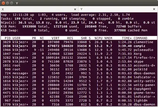

While playing around, I found that it's not the command at all - it's the profile.
Go to:
Edit | Profiles | (Default) | Edit | Title and Command
and change the "When Terminals Set Their Own Title" option to "Keep initial title", at the bottom of the list. Now, when you launch a command with a title, it'll stick around, so your command will work properly.
