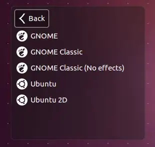

I've solved my problem. I installed gnome-shell environment and dropped Unity.
sudo apt-get install gnome-shell
Then logged out and chose GNOME
Choosing GNOME instead of Ubuntu
This removed the compize process from my $top list and replaced it with Xorg and gnome-shell (not sure if Xorg were on the list previous to the change of desktop envirement). These two processes average about 5% of the CPU combined.
