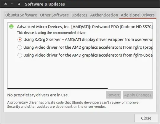

then go to Software center>Edit>Software Sources...>Additional Drivers. Then select your default open source driver. It will probably be the first option in the window and you must select it. See in this image.Note that the window in the image might not be exactly like yours. This image is from my system with AMD Radeon 5570 HD graphic card.
Note that the image might not be exactly like yours. This image is from my system with AMD Radeon 5570 HD graphic card.
