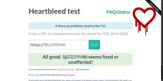

There seems to be a lot of people worried about this. I didn't noticed any update but you can test your server here.
Not sure how reliable it is, but it's an open source project so maybe somebody can check it out. Just to point out I didn't do any manual upgrade or anything, just the normal updates from the official repositories.
