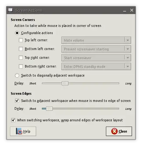

You can use brightside to accomplish this, It has a option to wrap around when you mouse hits a screen edge.
  1. Install brightside with:
    sudo apt-get update
    sudo apt-get install brightside
  2. In terminal run:
    brightside-properties
  3. This box should then appear:
Lasstly Check the boxes that say:
[✓] Switch to adjacent workspace when mouse is moved to edge of screen
[✓] When switching workspace, wrap around edges of workspace layout
