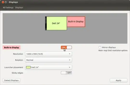

Just open the Displays settings and turn off the laptop display (Built-in Display on the picture below).
If you unplug your external monitor it will come back again. And of course if the HDMI monitor is re-plugged, the laptop display will turn off as expected.
