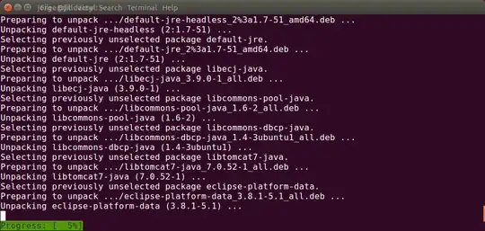

I've heard that apt has a new fancy colour and progress bar feature, but that I have to manually enable it.
How do I do this?

Now enjoy apt progress bars in all their glory:
