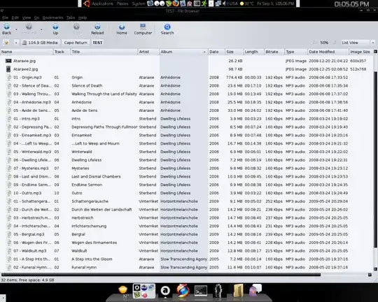

Use a script! For things not in Nautilus by default you can add scripts yourself.
More information on ubuntuforums. The topic starts out adding music information but from reply #32 it also involves images. Scripts (use at own risk) and instructions in the link.
Look at the screenshot for how this will look (it's for an older Ubuntu but this still works):
