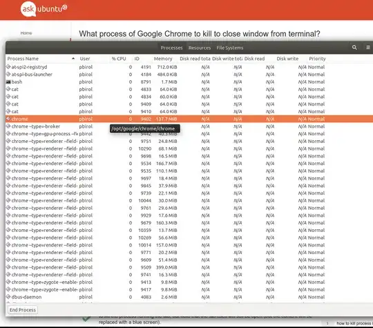

As another option without using the command line is:
  1. Show Applications > System Monitor
  2. Go to the process name chrome
  3. Right click on it and choose End (or Kill)
