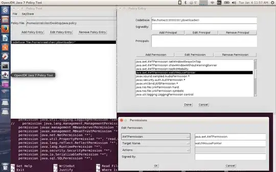

Note:
Java Policy Tools is a GUI tool to edit policy files. It make it more easy t find out all available options from drop box. It should be already install with Java package.
