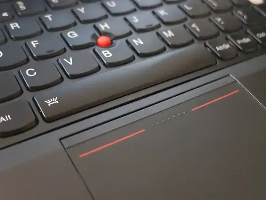

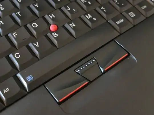

I want to use this
as this:
Specifically, I'm trying to enable scroll wheel emulation using the TrackPoint when the middle button 2 of the clickpad is pressed.
I've examined the xev output when a TrackPoint is used for scrolling with dedicated buttons (button 4 is recognised as a scroll up operation and button 5 is recognised as a scroll down operation) but the behaviour is different when using the clickpad buttons (button 2 is recognised in isolation). It appears that a modified driver is needed in order to enable scrolling using the middle button of the clickpad.
