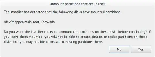

    • Do not unmount anything when asked Don't unmount

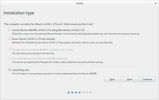

    • Choose a custom install Custom install

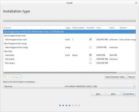

    • Specify partitions that will contain / and /boot Mount points
