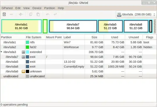

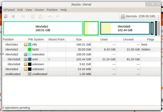

I'm trying to resize my ntfs partition but can't do it in GParted... tried from HD and from LiveUSB... couldn't find a solution on the web, partition isn't mounted; I'm trying to divide it in two to install another Ubuntu version.
I used Ubuntu 13.10 in both installed on HD and LiveUSB.
ntfs-3g is installed; ntfsprogs can't be installed.

As @psusi said I couldn't edit the partition because CHDISK was scheduled to run... then I just entered Windows and waited for it to finish, then partition was able to be resized by GParted.
Then did reorganization as @oldfred stated.
Package ntfs-3g substitutes ntfsprogs (which is an old package)
Thank you for the help!!

I met the same problem today when I tried to resize the partition(ntfs) for Windows. I tried with 'other modes'-->'removal later' mode to enter Gparted, and there was no this problem. I don't know why, but you may try. ps: my Gparted is Gparted-live.
