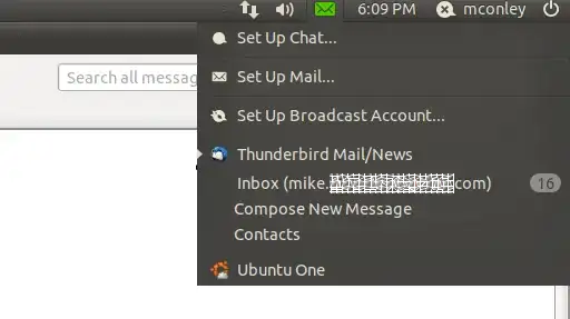

I use Thunderbird instead of Evolution for my mail client, so I'd prefer if I could replace Evolution with Thunderbird in the messaging component of the Indicator applet. Does anyone know how to do this?

You want the Mozilla Notification Extensions, aka messagingmenu-extension.
But it will not delete the evolution entry, to do that you need to remove /usr/share/indicators/messages/applications/evolution
The upstream source for the addon is available on Launchpad if you care to inspect it.

If you want to install the plugin for all users, it's better to use the upstream's PPA:
sudo add-apt-repository ppa:ruben-verweij/thunderbird-indicator
sudo apt-get update && sudo apt-get install xul-ext-indicator

My add-on was made to replace to evolution, but If you want remove the evolution indicator and maintain the evolution, only you need deinstall evolution-indicator package (sudo apt-get remove evolution-indicator)
If you want the evolution-indicator back, reinstall evolution-indicator (sudo apt-get install evolution-indicator). You need restart your session after uninstall or reinstall the package
