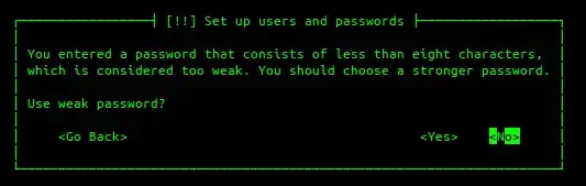

I have used the kickstart generator tool to generate a kickstart/preseed file for ubuntu KVM installations which has worked well until now. It stopped working when I switched over to using a very weak password, which results it halting on an additional option shown below:
What do I need to add to the kickstart file in order to confirm that this is ok?

You need to expressly answer that installer question. The last line is what you need. The source documentation is here: Link to Ubuntu Preseed documentation and examples
Simply add the following line to the kickstart file:
preseed user-setup/allow-password-weak boolean true
It appears that one can just replace d-i with preseed in order to get the normal preseed instructions to work such as here.
Full credit to @Hamy and @Jeremy which this answer is fully derived from. I just wanted to put an "idiots guide" answer for people like myself.
