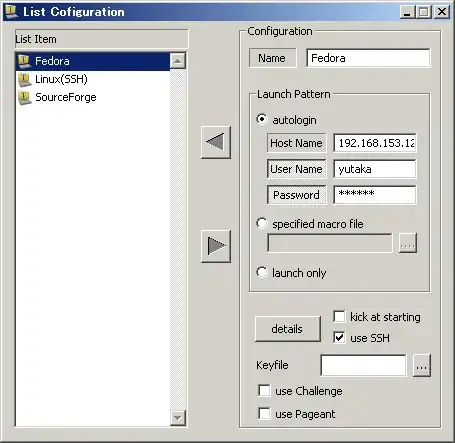

I found a screen-shot of the Terra term Menu on the net:
That's what I am crying for.
Do you have a hint?
This is how Terra Term Menu looks like

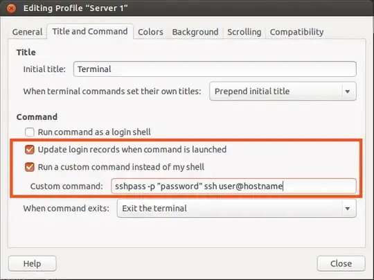

The good news is that you can use your already installed gnome-terminal to accomplish what you wish. Yes, the default terminal in Ubuntu.
You have to create a profile for each server where you want to connect.
First you need to install sshpass - a tool for non-interactive ssh password authentication if you don't have it already installed:
sudo apt-get install sshpass
And now I will show you an example to illustrate how you must create a profile for one server where you will connect via ssh:
  1. Open a Terminal and click on FileNew Profile.
  2. Type in the Profile name for the Profile such as the server where you want to connect.
  3. After you click Create a new windou will pops up; go to the Title and Command tab.
  4. Tick on Update login record when command is launched.
  5. Tick on Run a custom command instead of my shell.
  6. In the Custom command box add something like:
    sshpass -p "password" ssh user@hostname
  7. Close.
edit gnome-terminal profile

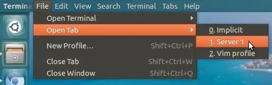

From now you cat automatically connect to the desired server via ssh from gnome-terminal when you will open a new window or new tab from the File menu:
open a new tab with profile from gnome-terminal
