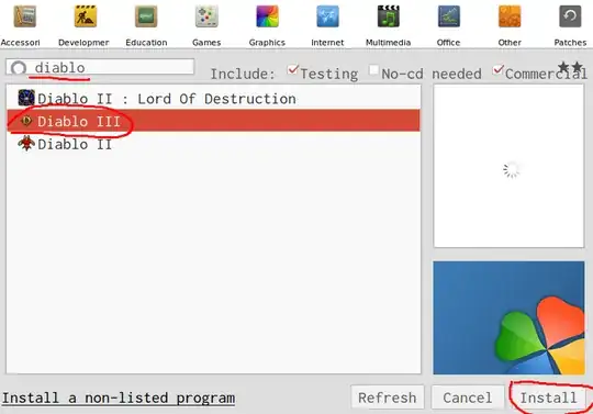

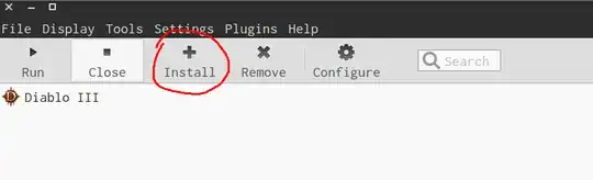

Execute playonlinux, Click Install button.
Search for Diablo 3, then click install.

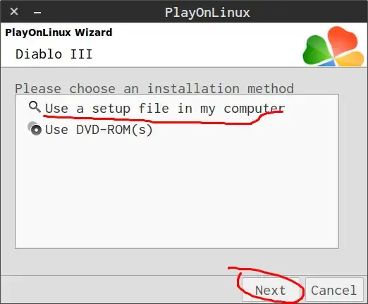

Then choose setup file from my computer, and pick file you downloaded in step 2.
Now install Diablo 3 as usual, login to battle.net and download D3 game.

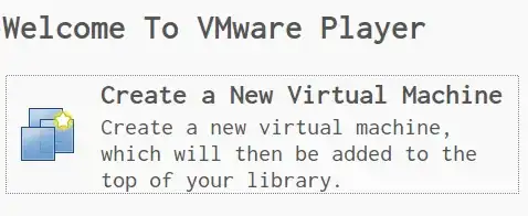

Another approach is installing D3 to Windows 8.1 virtual machine.
1. Go to the official site and download vmplayer, for me it was VMware-Player-6.0.1-1379776.x86_64.bundle.
Make it executable
chmod +x VMware-Player-6.0.1-1379776.x86_64.bundle
And install running this bundle file
sudo sh VMware-Player-6.0.1-1379776.x86_64.bundle
2. Download and Install Windows 8.1 image.
Get latest Windows 8.1 image somewhere.
Run vmplayer. Choose Create a New Virtual Machine
Then choose Use ISO Image and pick downloaded W8.1 image.

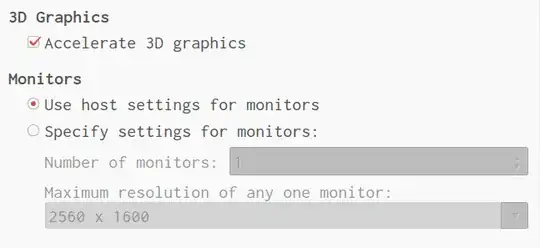

Install Windows as usual. After installation power off virtual machine, go to Virtual Machine Settings, and check that 3D Acceleration for W8.1 is on.

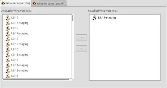

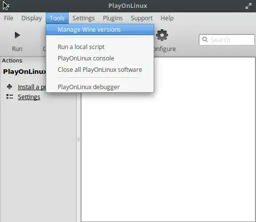

  2. Install the latest version of wine-staging: Tools > Manage Wine versions
    Manage Wine versionschoose version

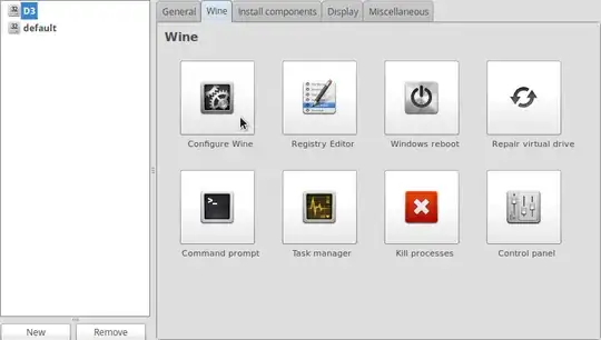

  3. Create a new virtual drive: Configure > New > 32-bit installation > pick the staging version you just chose > write any name (I wrote "D3")
  4. Select this drive in the Configuration menu (should be alongside default) and tab over to the "Wine" tab and click on "Configure Wine" Configure Wine

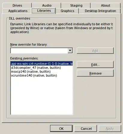

  5. A "Wine configuration" window will pop up. Go to the "Libraries" tab and add these libraries: api-ms-win-crt-runtime-l1-1-0, d3dcompiler_47, msvcp140, vcruntime140. Click Apply/Okay.
    Wine configuration
