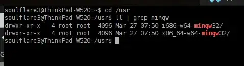

I just installed the packages and it looks like it installs them into /usr if you install using the Software Center or apt. Below is the screenshot.
screenshot
