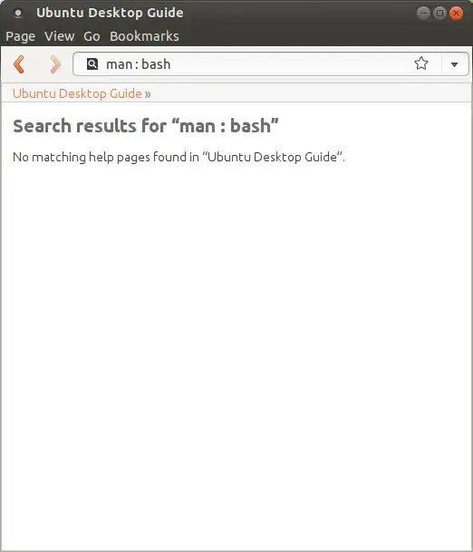

When I was introduced with Ubuntu 8.04, the Yelp (Ubuntu documentation) was aware of man command: simply type man:<manpage> into the search string showed the desired man page in HTML look and feel. However, since release 13.04 this feature looks like has been removed.
missing feature

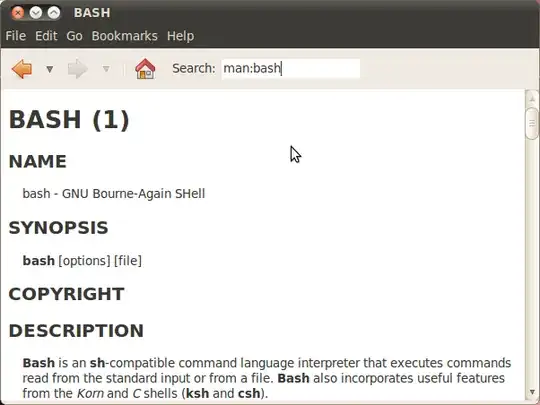

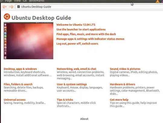

Here is the screenshot of Yelp from 10.04:
yelp 10.04

This is not a bug. They just change the manner how to search man pages.

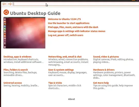

You can solve this by this trick: :)
Open yelp

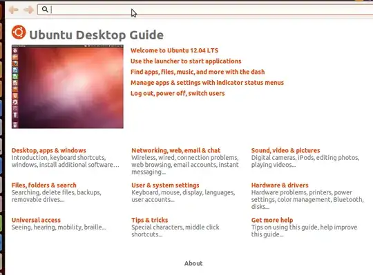

Then when pressing on the search field

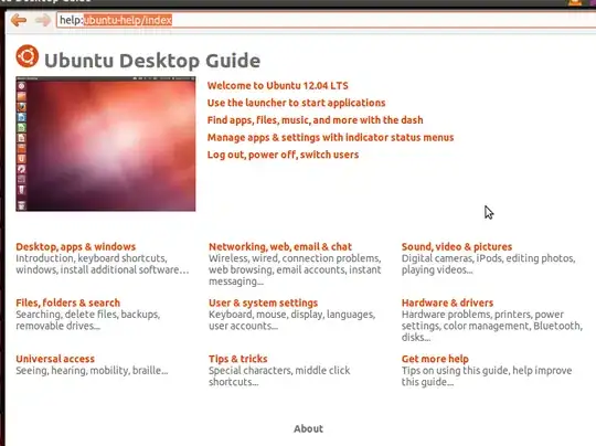

press ctrl+L
Then remove the keywords "help" or "help-list". Be sure you clean up the address

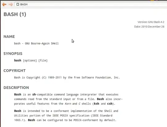

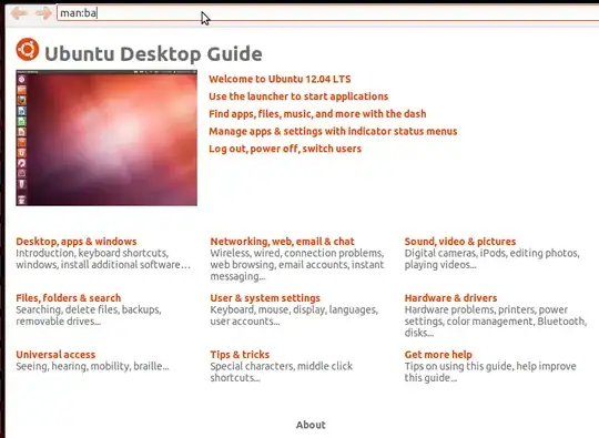

now you can enter man:bash
Enjoy
