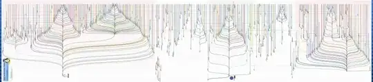

This is because the Linux ecosystem contains many many different sub branches (click on the image for a larger version)1:
Now, one of the basic differences between these distributions is the package manager they use. Debian and its derivatives (one of which is Ubuntu) use dpkg which deals with .deb packages. The other large player is the RedHat Package Manager (rpm) which works with .rpm packages. Other distributions have their own system or use a wrapper to install directly from source or even have no package manager at all.

1 Image taken from this Wikipedia page.
