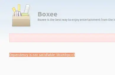

anyone can help me to installing boxee in ubuntu natty 11.04, there is an error "Dependency is not satisfiable: libxmlrpc-c3"

There is a workaround to "correct" the dependency that can no longer be satisfied in Natty (i.e. that library in your screenshot).

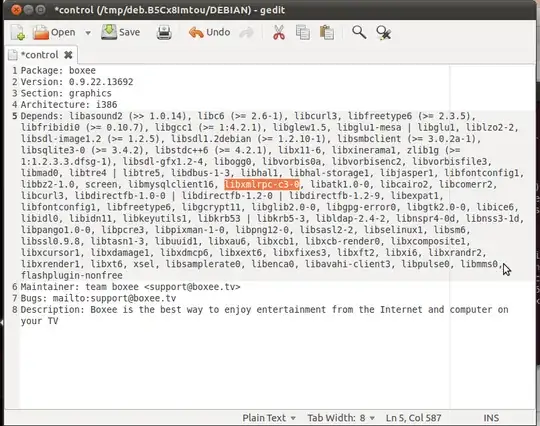

This will open a text editor with the contents similar to the screen-shot below
change the value of libxmlrpc-3 found in the file to the value shown in the screenshot:
Save the file in the text editor and close the file.
This will create (after a while) a new .deb file in the Downloads folder. You will see the name as boxee...modified.deb
Double click that file in File Manager (nautilus) - it should open the software-center, but this time, the dependencies error should no longer be there.
