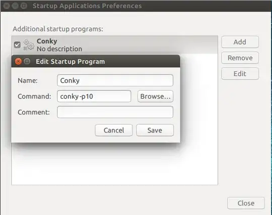

The easiest way is to add it to your Startup Applications and use the -p or --pause=SECONDS argument.

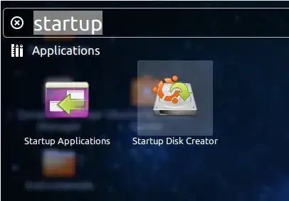

Open Startup Applications
Click Add and enter the following:
Where -p10 means wait 10 seconds after boot to start Conky
You can also use conky --pause=10
Or set the timeout to whatever you feel comfortable with

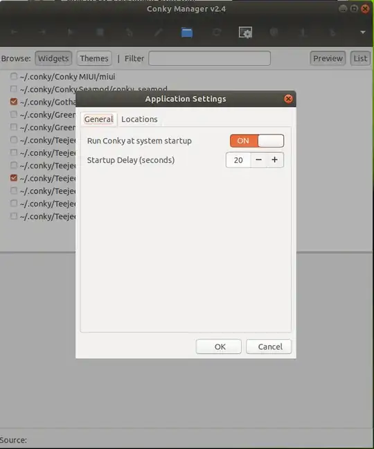

Easiest way is to use Conky Manager.
conky manager settings
