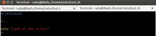

You must to have/create a file named .vimrc in your home directory with the following code inside:
let &titlestring = $USER . "@" . hostname() . " " . expand("%:p")
if &term == "screen"
  set t_ts=^[k
  set t_fs=^[\
endif
if &term == "screen" || &term == "xterm"
  set title
endif
Source: gnome-terminal does not allow changing the title
