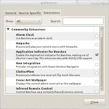

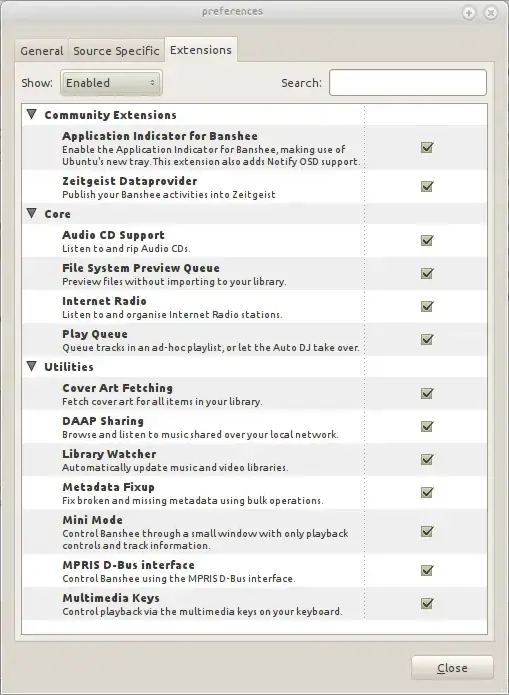

Try my suggested* method for taming banshee. It worked for me to bring banshee down from around 50%->75%, to around 10%->20%, and it might work for you.
Edit: Under advice, I've decided to post the details here :) (defeats my laziness).
  • Open the Banshee preferences, and find all the addins you are not really using, and probably won’t for a while:
  • Disable even the slightest – including last.fm suggestions etc. Here is what my list looks like now:
**The link is to my blog, to avoid typing it all over again.*
