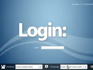

after installing I tried
sudo dpkg-reconfigure gdm
selected lightdm, rebooted and it is now working.
Yes, it did show blank black screen while i was trying
sudo stop gdm
sudo start lightdm
sudo lightdm
