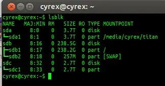

Which is fairly easy, simply open your terminal, open the fstab file and add the discard option to the SSD UUID that corresponds to your Samsung SSD. Basically open the terminal and:
blkid
which should show you all HDD/SSD so you can see which one is which:
Here my SSD is sdb which is the one that has the root filesystem with it (the little / you see there at the end of the line that starts with sdb1). I then:

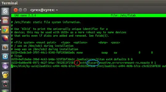

sudo nano /etc/fstab
And look for the root filesystem (The / "slash") marked with the Red circle. I then add the discard option (marked with the blue circle) to the several options shown there. In my case it reads discard,noatime,errors.... since I only needed to add the discard and a comma. Note that the discard is AFTER the ext4, this is because each section or columns is for an specific part of fstab. The 3rd column is for the filesystem type, which is ext4 in this case. The 4th column is for the options, which is were discard is.
Now save the file by pressing CTRL+X which will show you a message below saying if you want to save the file, press Y and you are done. Now reboot the computer and you are ready.

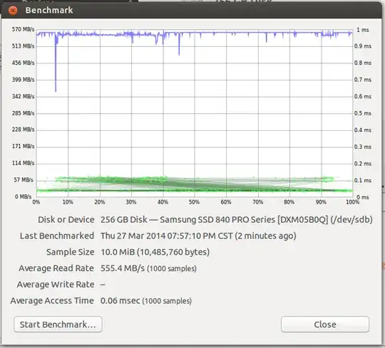

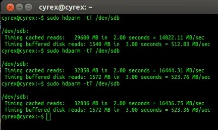

Some benchmarks for that particular SSD will help you enjoy that fast drive:
NOTE: Gnome Disk has a problem with this SSD when doing a benchmark with Write enable. It is a bug that they are working to fix.
