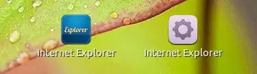

Replace /path/to/iconfile (the value for Icon field) with the path of an icon file (like Icon=/home/username/Pictures/internet-explorer.png) or you can omit this line of entry.
On the left is a shortcut with icon specified, for the one on right, not. iconField

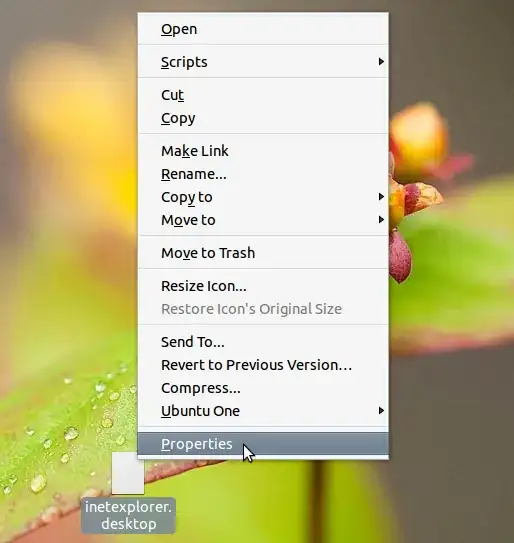

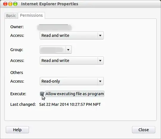

  1. Turn on the file's execute bit on.
Graphically you can do it by right clicking the .desktop file, and from the context menu select Properties. In the properties window, select Permission tab, look for a label Execute: and check-mark the check-box next to it so that the shortcut becomes executable.
selecting property from right-click context menu rightClickTheFile
setting execute permission executableProperty

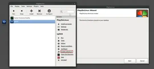

I suggest you to use PlayOnLinux, in combination with wine, which offers a clean and user-friendly interface, that let you install and manage windows software and games.
PlayOnLinux is a piece of software which allows you to easily install and use numerous games and apps designed to run with Microsoft® Windows®. Few games are compatible with GNU/Linux at the moment and it certainly is a factor preventing the migration to this system. PlayOnLinux brings a cost-free, accessible and efficient solution to this problem.
Here is a non-exhaustive list of the interesting points to know:
  • You don't have to own a Windows® license to use PlayOnLinux.
  • PlayOnLinux is based on Wine, and so profits from all its features yet it keeps the user from having to deal with its complexity.
  • PlayOnLinux is free software.
  • PlayOnLinux uses Bash and Python.
Nevertheless, PlayOnLinux has some bugs, as every piece of software:
  • Occasional performance decrease (image may be less fluid and graphics less detailed).
  • Not all games are supported. Nevertheless, you can use our manual installation module.
Installation:
  1. Simply use Software-Center to install it,
  2. or refer to their HP installation info.
