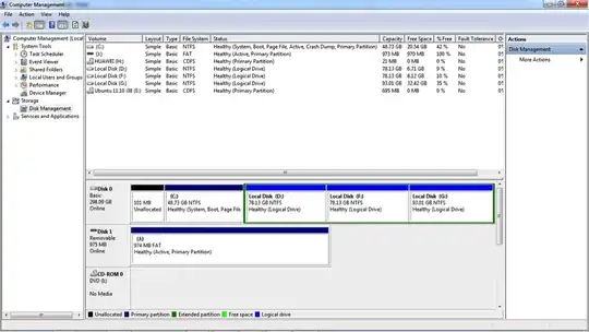

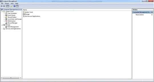

Go To “Computer Management”.
1.2 Go To “Disk Management”.

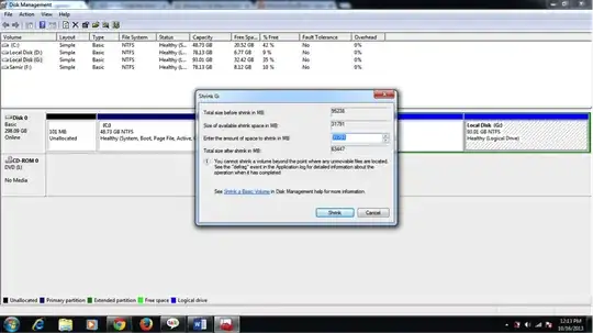

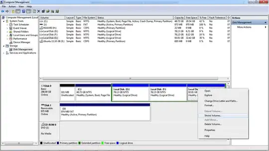

1.3 Right Click on Disk you want to Partitioned, Select “Shrink Volume”. enter image description here
1.4 Enter the amount of space to shrink in MB. Then click Shrink. This will create New Partitioned Disk with disk amount entered by you.

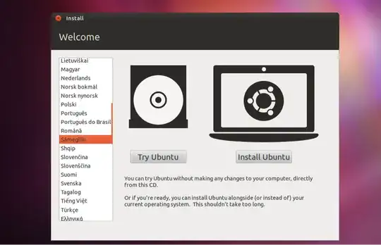

Once done you need to reboot and boot from your Ubuntu Live CD or USB (Read this for more info: http://www.ubuntu.com/download/desktop/install-desktop-latest)

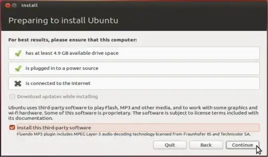

When you are ready to install Ubuntu on your hard disk, click the Install Ubuntu button. The installation wizard will appear:
Click Continue
and select the desired options. Click Continue. The Installation type window appears.

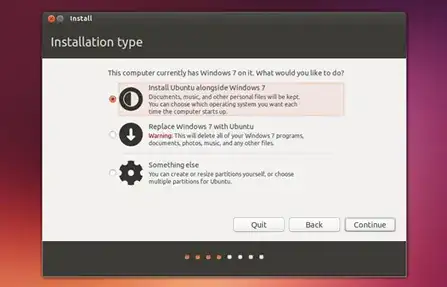

If you want to install Ubuntu alongside you other systems (eg alongside Windows), select the Install Ubuntu alongside them.
then Click Continue and follow the on screen instructions.
