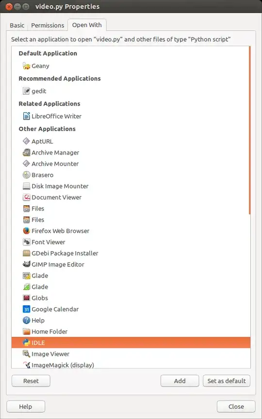

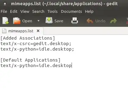

I have followed the instructions in this thread: How do I set IDLE as the default editor for Python scripts?, but it hasn't resulted in the option to open in IDLE being shown.
So I used the 'Find applications online' option in the 'Open with...' menu and installed SPE (Stanli's Python Editor) at it's recommendation, but the option to open .py files with that also isn't in the menu.
Does anyone have any suggestions? I'm running ubuntu 13.10 and am trying to use Python 3.3.
Thanks in advance.

OPTION 1:
Edit your $HOME/.local/share/applications/mimeapps.list if you want such association to be only applied for your user.
Add the following lines:
[Default Applications]
text/x-python=idle.desktop
[Added Associations]
text/x-python=idle.desktop;
Note, if you want the .py association for all users the file to modify is (using sudo):
/usr/share/applications/defaults.list

Needless to restart your session or computer, to set the default application for the python type, locate a file of that type (*.py) in the file manager, right-click it, and select Properties.
Click the "Open With" tab and select the application you want to use for that file type.
Use the Set as default button to make the application the default application.
From now, clicking on a python file should open your preferred editor.
