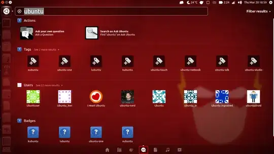

Unless you use website lenses and not all websites have them. I will give you an example with this site:
Install the Ask Ubuntu lens:
sudo apt-get install unity-lens-askubuntu
In your Dash, you will get an askubuntu icon. See screenshot below after I have searched for 'ubuntu'.
Here is a list of available unity lenses: What lenses for Unity are available?
