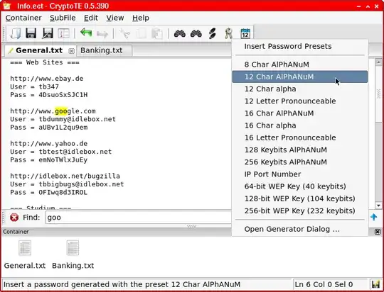

CryptoTE
According to the website.
CryptoTE is a text editor with integrated strong cryptography.
It is based on the popular Scintilla widget and automatically stores
text data in secure encrypted container files.
Compared to other "password keeper" programs, CryptoTE does not force
any structure upon your data: it works with plain ASCII text
and does not require you to fill in grids, key-value attributes,descriptions etc.
Encryption is transparently performed using the
highly-secure Serpent cipher. The editing interface is thoroughly
optimized for speed and ease of use.
Multiple subfiles, Quick-Find and a two-click random password generator
make daily use very convenient.
for ubuntu see.

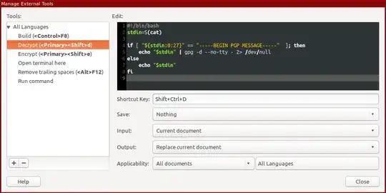

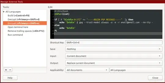

Just go to Tools > Manage External Tools, and add the scripts:
ENCRYPT
Paste the following code on a new command, called “Encrypt”:
#!/bin/bash
stdin=$(cat)
if [ ! "${stdin:0:27}" == "-----BEGIN PGP MESSAGE-----" ]; then echo "$stdin" | gpg -a -e -r email@email.com --no-tty - else echo "$stdin" fi
with the options:
  • ShortCut - Control + Shift + E
  • Save - Nothing
  • Input - Current document
  • Output - Replace current document
  • Applicability - All documents / All languages
DECRYPT
Paste the following code on a new command, called “Decrypt”:
#!/bin/bash
stdin=$(cat)
if [ "${stdin:0:27}" == "-----BEGIN PGP MESSAGE-----" ]; then echo "$stdin" | gpg -d --no-tty - 2> /dev/null else echo "$stdin" fi
with the options:
  • ShortCut - Control + Shift + D
  • Save - Nothing
USAGE

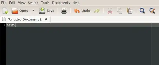

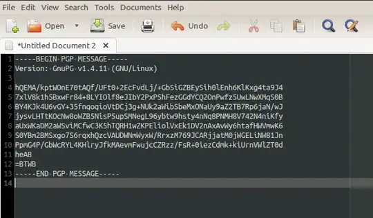

Once that is done, then you can open encrypted files (asc – ascii files, not binary), or create new ones on spot using the shortcuts.
Example:
