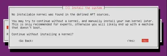

It generates an ISO without any errors, however the ISO those this wonderful error:
No kernel found

Breaking out to a shell after the 'bad kernel' message: When examining the keys found in /usr/share/keyrings with gpg --list-keys --keyring ./ubuntu-archive-keyring.gpg the signing key injected by UCK or manually through a ubuntu-keyring rebuild are NOT installed prior to the apt-cdrom call in the installer. As such, dists/trusty/Release.gpg fails gpg verification.
Manually running dpkg -i on the rebuilt ubuntu-keyring package installs the replacement keys correctly; both in /usr/share/keyrings and into the appropriate gpg envelope - however, exiting the shell, and reinstating the software installation at that point from the installation menu, does not fix the apt-cdrom gpg validation process - it looks as though gpg keys are getting injected from some other udeb, and ubuntu-keyring is not installed prior to the apt-cdrom check.
Unfortunately, the error message displayed, is not reflective of the underlying problem. The problem is that that apt-cdrom cannot verify the gpg signature, therefore doesn't recognise the CDRom as a valid package source. That means that there are no kernels available to install.
