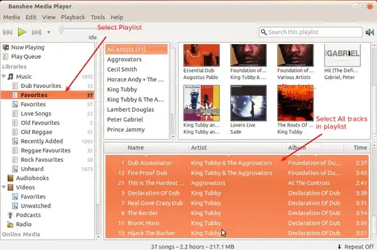

  • Select your playlist on the left. Make sure all Artists is selected in the top right pane.
  • select all tracks in playlist in bottom right pane.

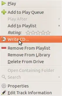

  • Right click and click Write CD.

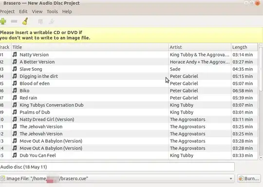

Brasero should start with all the tracks ready to be burned to CD, it will by default want to Write an audio CD, now there will likely be so many tracks that will not possibly fit on an audio CD so the next step is to change the brasero project.

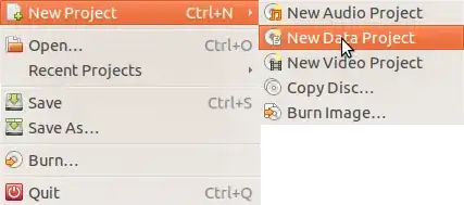

  • Click the project menu in brasero, then select New Data project in the flyout menu.
You will be asked "Do you want to discard the file selection or add it to the new project?"
  • Click the Keep file selection button.

Main Banshee window
Banshee write CD  menu
Brasero Audio CD project Window
Brasero Audio CD project, Change this to a Data project
Brasero project selection
The Brasero Menus showing how to change project type

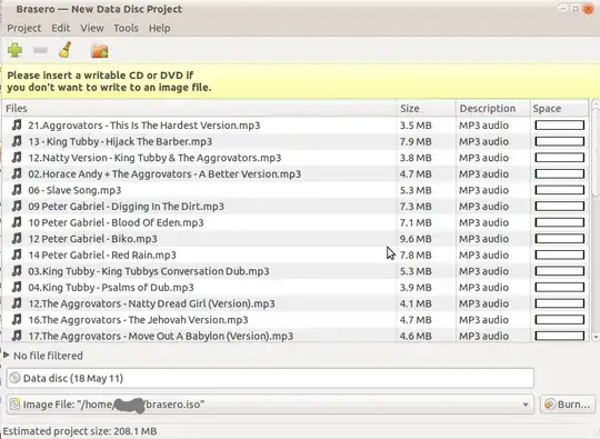

Brasero data cd project
The data project that can handle a fair amount of mp3s
