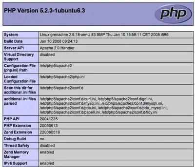

Put this in your root directory:
<?php
phpinfo();
Save it as phpinfo.php and point your browser to it (this could be http://localhost/phpinfo.php)
  • More information (you can get much more information than just the version).
  • Example (random image):
Screenshot of phpinfo() output
