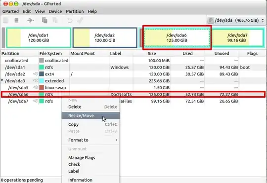

  • To create a new logical partition in the extended partition you'll have to shrink your current and only logical partition /dev/sda5. You can do this by right clicking the partition and selecting resize/move option. Then in the Resize/Move window that appears, you can move the slider from right end towards left (preferred option) to create an unallocated space of appropriate size that you want for your swap,
    snap1 (this snapshot shows a resize/move operation being selected for a logical partition.)

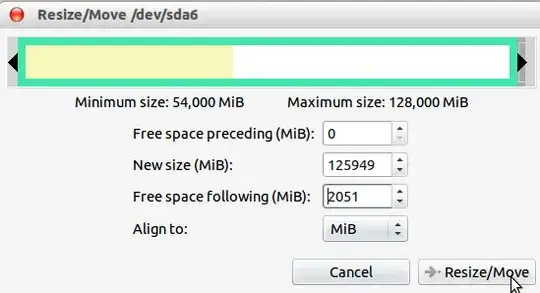

    snap2
    (here I've selected a size of 2051 MB for the new partition. Make sure your Align to: option is set for MiB)

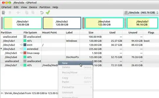

  • Right click the newly created unallocated space, and select New, snap3

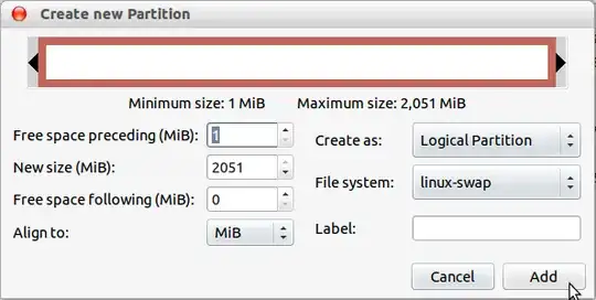

    then set File System to linux-swap and click Add; snap4
